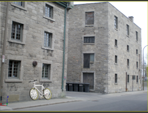

Now when you place objects in the scene, the camera's point of view makes the objects match the background.
- Use the other Perspective Match controls to refine the camera's position.
Tip: When you place objects against a perspective-matched background, you can use the Matte/Shadow/Reflection material (or, with the Default Scanline Renderer, the Matte/Shadow material) to cast shadows against the background.
Bicycle geometry casts a shadow on an (invisible) object with the Matte/Shadow/Reflection material.
