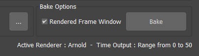

  3. Choose Menu bar > Rendering > Bake to Texture to open the Bake to Texture dialog.
    The active renderer and time output range is shown on the bottom right of the Bake to Texture window.
