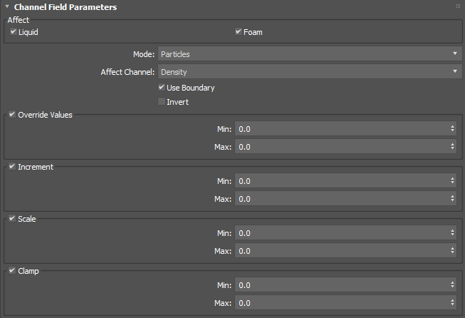

Channel Field Parameters rollout
Affect group
Liquid
When enabled, the channel field will affect the liquid component of the simulation.
Foam
When enabled, the channel field will affect the foam component of the simulation.
Mode
Sets whether to modify a channel defined on particles or voxels. Some channels are available for particles or voxels only, while some are available for both.
Affect Channel
Sets the specific channel to modify.
The available channels are:
  • Age
  • Air Distance
  • Churn
  • Curvature
  • Density
  • Droplet
  • Expansion Rate
  • Position
  • Stiction Bandwidth
  • Stiction Strength
  • UV
  • Velocity
  • Vorticity
Use Boundary
When enabled, applies the effect only within the volume specified by the object's boundary shape.
Note: Unlike the boundary controls for emitters, colliders, guides, and foam masks, you can use other shapes besides box or sphere in order to define the volume.
Invert
When enabled, applies the effect outside of the boundary rather than within.
Override Values group
Override Values
When enabled, sets each value in the channel to a uniformly distributed random value between the Min and Max in the Override attribute block.
Min
Sets a minimum for the random value.
Max
Sets a maximum for the random value.
Increment group
Increment
When enabled, adds a positive or negative increment to each value in the channel. The increment is a uniformly distributed random value between the Min and Max in the Override attribute block, and is added over time, with every frame changing by the increment amount.
Min
Max
Scale group
Scale
When enabled, sets each value in the channel to a uniformly distributed random value between the Min and Max in the Scale attribute block.
Min
Max
Clamp group
Clamp
When enabled, clamps each value in the channel between Min and Max in the Clamp attribute block.
Min
Sets a minimum for the clamp value.
Max
Sets a maximum for the clamp value.

  1. From the Helpers panel, select Volume and add a volume helper to the scene.
  2. From the Liquid Attributes panel in the Simulation View window, click Pick in the Channel Fields rollout to pick the volume helper from the viewport. Alternatively you can click Add and select the helper from a dialog.
  3. From the Solver Parameters panel in the Simulation View window, select the added volume helper under Channel Field Objects. The Channel Field Parameters rollout appears.
  4. In the Channel Field Parameters rollout, configure the various settings for the channel field.
