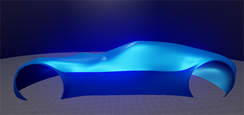

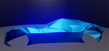

- Turns on Box mode, which displays sub-d objects at their lowest level of division. Use this mode to better detect surface quality problems, such as odd-sized faces, uneven edges, or other surface irregularities.
Box mode on
Box mode off

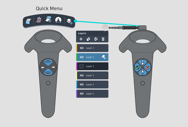

The Quick Menu on the Global Hand displays tools that are relevant to your current selected tool and task. The Layers palette is also accessible with the Quick Menu and lets you easily work with layers while modeling.
There are two constant tools in the Quick Menu, toggle Box/Smooth mode on the left and toggle Object/Layer-move on the right, and three contextual tools in the middle. For example, when modeling sub-d primitives, the Quick Menu (shown in the image above) will display the Box mode icon, the Sub-d extrude tool, the Move sub-d CVs tool, the Weld tool, and the Object/Layer-move icon.
Access the Quick Menu by pressing up on the Global Hand analog stick (Oculus) or D-pad (VIVE). Pointing the Tool Hand towards the Quick Menu will automatically cast a ray and you can select your desired tool by pulling the Tool Hand trigger.
