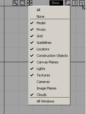

Show or hide items from the window title bar
This is the easiest and quickest way to change the visibility of items in a single window.
  1. Click the Show button in the title bar of the window where you want to change the visibility of items.
    A menu is displayed.
  2. Click an item type to show it (check mark) or hide it (no check mark).
