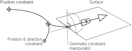

Blend curves are controlled by blend points acting as constraints:
You create the curve by setting up the constraints, such as
...and so on. Alias draws the curve to satisfy the constraints, and automatically updates the curve when the constraints, or the objects the curve is constrained to, change.
There are three main types of blend points.
Location: forces the curve to pass through the blend point’s location in space.
This is the type you create when you first draw a blend curve.
Direction: forces the curve to pass through the blend point’s location in space traveling in a certain world space direction.
There are two subtypes of direction:
Geometry: forces the curve to pass through a point on a curve or surface and travel in a direction relative to that curve or surface.
