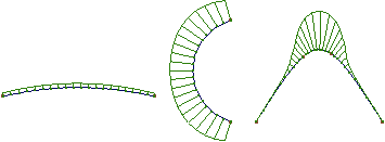

Consider the following cross sections:
The shape on the left has low curvature. The shape in the middle has high curvature. The shape on the right has two changes in curvature.
You want to break up large-scale areas into areas of low curvature and high curvature at the points where the curvature begins to increase.

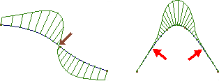

You want to break up shapes where the curvature changes direction (called inflections, shown in the following image on the left), and where curvature begins to change (shown in the following image on the right).

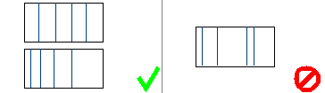

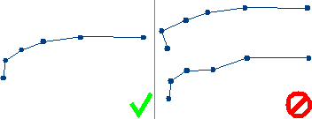

A good distribution:
Puts more CVs in areas of high curvature.
Has even or smoothly changing spacing between hulls.
Has consistent direction change along hulls, with no zigzags, W shapes, or pronounced peaks.
