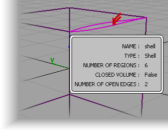

To identify open edges in stitched shells:
Use Object Edit > Query Edit
to check for open edges in shells. Red arrows clearly mark gaps in the shell.
