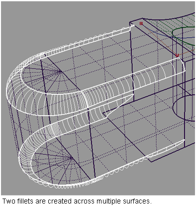

Create surfaces that round off the edges and corners between existing surfaces.
In the Surfaces tool palette, select the Round tool
Select an edge shared by two surfaces which meet at an angle.
The common edge is highlighted in green with two blue squares indicating the end points.
A radius manipulator with a radius value appears on each edge.
Click on the manipulator handles to move it or change the radius value. You can also type a new radius value.
Click on the edge to add extra radius manipulators at those locations and adjust the radii.
This will set the fillet radius at those points. You can specify as many radii along an edge as you want.
Hold
and click on an edge or radius to remove it.
Repeat steps 2 to 4 for any number of shared edges on your model.

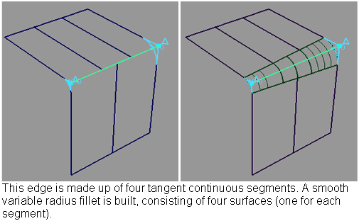

If two edges are tangent continuous, they are treated as a single edge and a single fillet is built.
Click the Build button.
Fillet surfaces are built along each shared edge. All new surfaces are grouped under the same DAG node.

If two or more edges are tangent continuous, they are treated as a single edge. Creating a smooth variable radius fillet across the surfaces then requires only two radius manipulators (rather than one for each edge). However, the fillet will be made up of a separate surface for each edge.

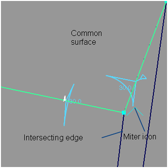

To successfully create a mitered surface, one surface is common to both edges; the other two surfaces must intersect.
Select two edges that meet at a corner.
The shared edges are highlighted in green with blue squares indicating the end points.
Radius manipulators and a corner shape manipulator appear.
Adjust the radii on the two edges as desired.

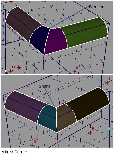

Click on the corner shape manipulator to toggle between Sharp and Blended corner treatment.
Four surfaces are built: two fillets and two surfaces at the corner.
If one of the two edges has a radius of 0.0, no corner surfaces are built, only a single fillet.
You can still modify the radius manipulators and click Build again to rebuild the surfaces.
If you need to select extra edges or deselect some edges, click the Revert button.
The fillets and corner surfaces are removed, and surfaces are untrimmed. You can then select/deselect edges, then click Build again.
