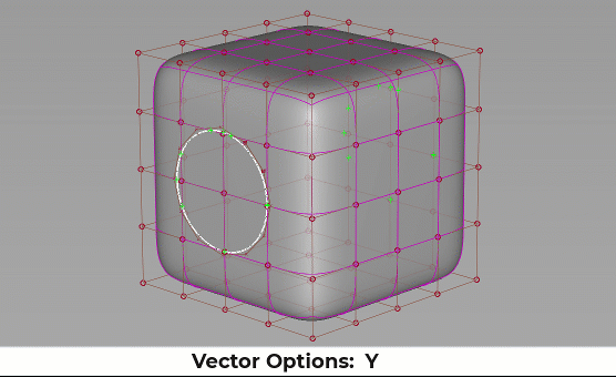

  2. In the control window, turn on 3D Trimming and choose a Vector Option.
    If you select Normal, the curve is projected onto each point on the surface along the normal at that point, instead of along a single vector direction. For more information, see Vector Options

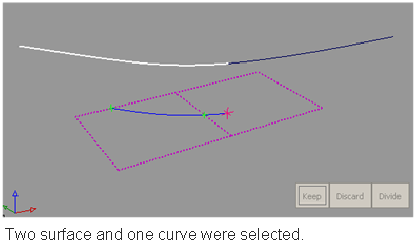

  3. Select all the surfaces you want to trim. Hold down the key to pick more than one surface, or use a pick box.

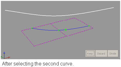

  4. Select the curves you want to project onto the surface to create trim curves (curves-on-surface). If the desired curves-on-surface are already present, you can skip this step.
    Note:
    The surfaces and curves can be selected in any order, but the first object selected must be a surface.

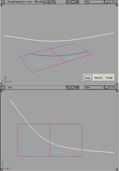

    As you select surfaces and curves, the curves are automatically projected onto the surfaces, and the corresponding trim curves are displayed on the surfaces. The direction of the projection is determined by the set Vector Option.The default View, which sets the direction of projection based on the view vector of the window where you selected the curves ( that is, perpendicular to the window). To project normal to the surface, you must select the Normal option.

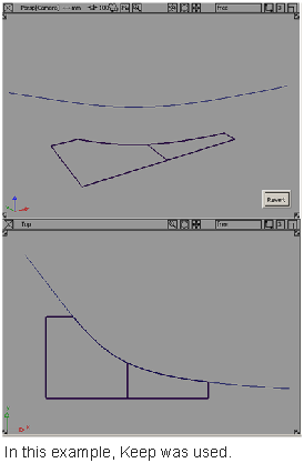

  8. Click one of the buttons: Keep, Discard, or Divide, depending on the type of operation you want to perform.
    Keep: Keeps the regions selected in step 5, and discards the rest.
    Discard: Discards the regions selected in step 5, and keeps the rest.
    Divide: Divides the selected regions from the others (making separate trim surfaces) but keeps all the regions.
  9. After the trim operation has been performed, you can undo it by clicking the Revert button.
    You are left within the tool with all your selections intact, so you can adjust your selections and trim again.

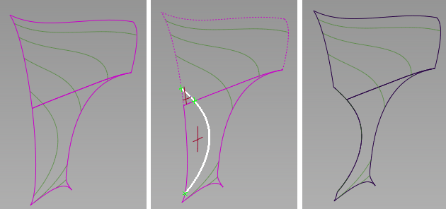

    A successful trim curve is shown with a green marker where the ends of the curve join.
    Note:
    An unsuccessful trim curve — as in this case, where a gap exists — has the two ends of the curve highlighted in yellow to call attention to the gap region.
