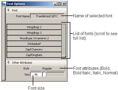

Double-clicking the tool opens the option window. A string of text is created as a single object; however, characters can be made into individual objects by choosing Edit > Ungroup. Each text character can be made of more than one curve. Initially, these curves are grouped together, but they can be separated by choosing Edit > Ungroup .
