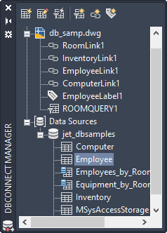

dbConnect Manager Tree View
Contains nodes for each drawing that's currently open and a Data Sources node that contains all available data sources configured on your system.
