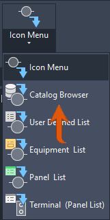

Catalog Browser
The Catalog Browser is the new interface for accessing the catalog content. The Catalog Browser is search-based. Enter your search criteria and select from a list of catalog values that match your search criteria.

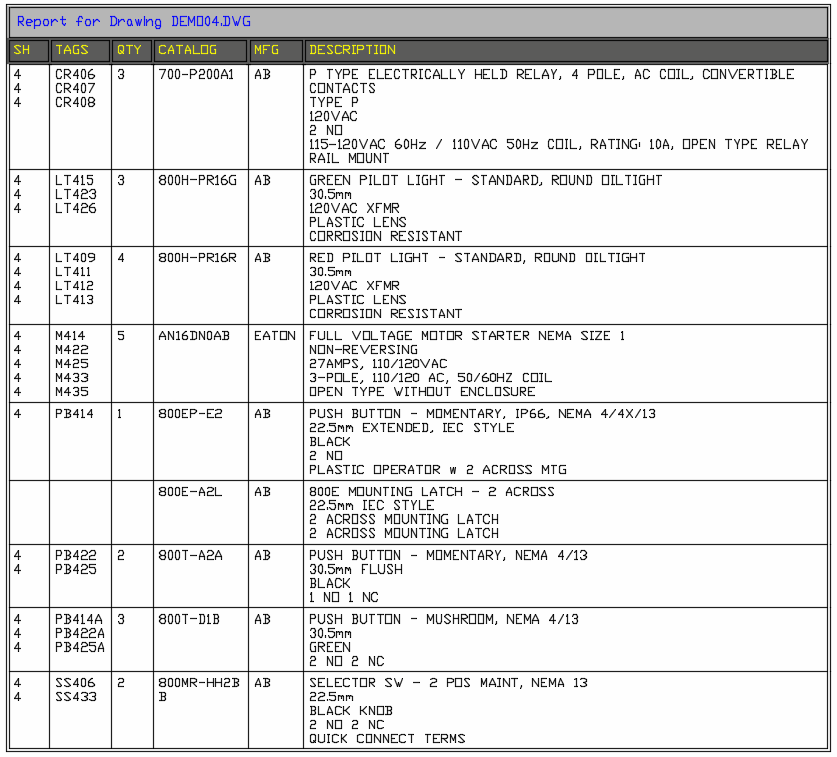

Report Tables
The Report Format Setup now lets you select a table style for report tables. Previously, individual settings such as text height, border style, and title options controlled the look of a report table. By using a table style for a report table, you have control over more settings, such as cell margins, title text height, header text height, and more.
