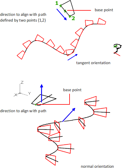

Tangent direction
Specifies how the arrayed items are aligned relative to the starting direction of the path.
2 points
Specifies two points that represent the tangency of the arrayed items relative to the path. The vector of the two points establishes the tangency of the first item in the array. The Align Items setting controls whether the other items in the array maintain a tangent or parallel orientation.
Normal
Orients the Z direction of the first item with the starting direction of the path curve.

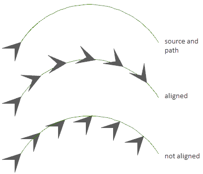

Align items
Specifies whether to align each item to be tangent to the path direction. Alignment is relative to the first item’s orientation.
