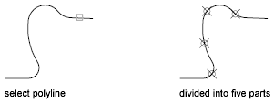

The illustration shows an arc divided into five equal parts using a block consisting of a vertically oriented ellipse.
