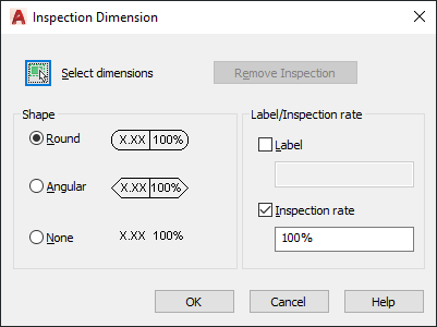

Allows you to add or remove an inspection dimension from selected dimensions.
DIMINSPECT (Command) Find
Use the Shape and Inspection Label/Rate settings to the appearance of the frame of the inspection dimension and the inspection rate value.
The following options are displayed.
Specifies the dimensions that an inspection dimension should be added to or removed from.
Removes the inspection dimension from the selected dimension.
Controls the shape of the frame that is drawn around the label, dimension value, and inspection rate of the inspection dimension.
Creates a frame with semi-circles on the two ends; the fields within the frame are separated by vertical lines.
Creates a frame with lines that form a 90-degree angle on the two ends; the fields within the frame are separated by vertical lines.
Specifies that no frame is drawn around the values; the fields are not separated by vertical lines.
Specifies the label text and inspection rate for an inspection dimension.
Turns the display of the label field on and off.
Specifies the label text.
The label is displayed in the leftmost section of the inspection dimension when the Label check box is selected.
Turns the display of the rate field on and off.
Specifies how frequently a part should be inspected.
The value is expressed as a percentage, and the valid range is 0 to 100. The inspection rate is displayed in the rightmost section of the inspection dimension when the Inspection Rate check box is selected.
