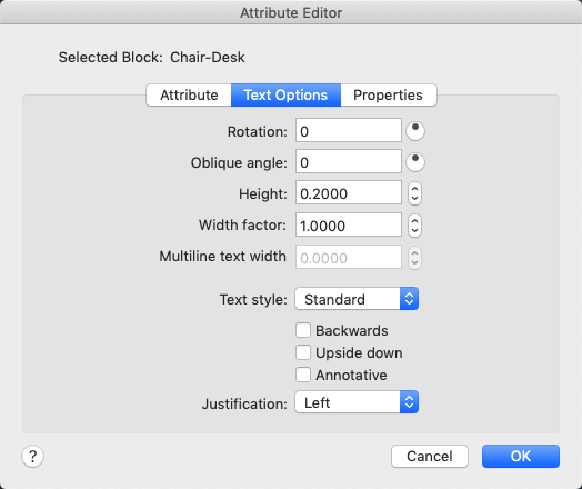

Sets the properties that define the way an attribute's text is displayed in the drawing. Change the color of attribute text on the Properties tab.
Specifies the rotation angle of the attribute text.
Specifies the angle that attribute text is slanted away from its vertical axis.
Specifies the height of the attribute text.
Sets the character spacing for attribute text. Entering a value less than 1.0 condenses the text. Entering a value greater than 1.0 expands it.
Specifies the maximum length of the lines of text in a multiple-line attribute before wrapping to the next line. A value of 0.000 means that there is no restriction on the length of a line of text. Not available for single-line attributes.
Specifies the text style for attribute text. Default values for this text style are assigned to the text properties displayed in this dialog box.
Specifies whether or not the text is displayed backwards.
Specifies whether or not the text is displayed upside down.
Specifies that the attribute is annotative.
Specifies how attribute text is justified.

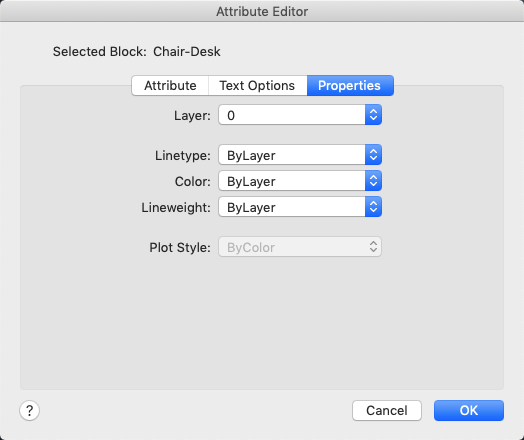

Defines the layer that the attribute is on and the color, lineweight, and linetype for the attribute's line. If the drawing uses plot styles, you can assign a plot style to the attribute using the Properties tab.
Specifies the layer that the attribute is on.
Specifies the linetype of attribute text.
Specifies the attribute's text color.
Specifies the lineweight of attribute text.
Changes you make to this option are not displayed if the LWDISPLAY system variable is off.
Specifies the plot style of the attribute.
If the current drawing uses color-dependent plot styles, the Plot Style list is not available.
