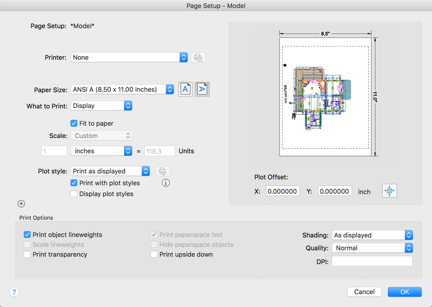

Specifies page layout and plotting device settings.
PAGESETUP (Command)
Toolbar:
 The Page Setup dialog box is displayed in the following cases:
- When you create a new page setup through the Page Setup Manager
- When you modify an existing page setup through the Page Setup Manager
- When you edit a page setup using PAGESETUPEDIT
- In the Quick View dialog box, when you right-click a layout and click Edit Page Setup
The page setup settings that you specify are stored with the layout and can be applied to other layouts or imported into other drawings.
Page Setup
  Displays the name of the current page setup.
Printer
  Specifies a configured plotting device to use when plotting layouts. Lists the available PC3 files or system printers from which you can select to plot the current layout.
  If the selected plotter doesn't support the layout's selected paper size, a warning is displayed and you can select the plotter's default paper size or a custom paper size.
- PDF Options or Printer Configuration
- If PDF output is selected, displays the PDF Options dialog box, which gives you the ability to optimize a PDF file for the specific purpose you are creating it.
- If a printer is selected, displays the Print dialog box where you can choose the printer settings. Printer settings are saved in a .pc3 file which can be selected the next time you plot.
Paper Size
  Displays standard paper sizes that are available for the selected plotting device. If no plotter is selected, the full standard paper size list is displayed and available for selection.
  If the selected plotter doesn't support the layout's selected paper size, a warning is displayed, and you can select the plotter's default paper size or a custom paper size.
  A default paper size is set for the plotting device when you create a PC3 file with the Add-a-Plotter wizard. The paper size that you select in the Page Setup dialog box is saved with the layout and overrides the PC3 file settings.
- Orientation
				Portrait. Orients and plots the drawing so that the short edge of the paper represents the top of the page.
				Landscape. Orients and plots the drawing so that the long edge of the paper represents the top of the page.
What to Print
  Specifies the portion of the drawing to be plotted.
		Layout/Limits. When plotting a layout, plots everything within the printable area of the specified paper size, with the origin calculated from 0,0 in the layout. When plotting from the Model tab, plots the entire drawing area that is defined by the grid limits. If the current viewport does not display a plan view, this option has the same effect as the Extents option.
Display. Plots the view in the current viewport in the selected Model tab or the current paper space view in the layout.
Extents. Plots the portion of the current space of the drawing that contains objects. All geometry in the current space is plotted. The drawing may be regenerated to recalculate the extents before plotting.
 View. Plots a view that was previously saved with the VIEW command. You can select a named view from the list. If there are no saved views in the drawing, this option is unavailable. When the View option is selected, a View list is displayed that lists the named views that are saved in the current drawing. You can select a view from this list to plot.
Window. Plots any portion of the drawing that you specify. When you select Window, use the pointing device to specify the two corners of the area to be plotted, or enter coordinate values.
Fit to Paper
  Scales the plot to fit within the selected paper size and displays the custom scale factor in the Scale, Inch =, and Units boxes.
Scale
  Defines the exact scale for the plot.
	 Custom defines a user-defined scale. You can create a custom scale by entering the number of inches (or millimeters) equal to the number of drawing units. The default scale setting is 1:1 when plotting a layout. The default setting is Fit to Paper when plotting from the Model tab.
Note: You can modify the list of scales with SCALELISTEDIT.
Plot Style
  Displays the plot style table that is assigned to the current Model tab or layout tab and provides a list of the currently available plot style tables.
  If you select New, the Plot Style Table Editor is displayed, which you can use to create a new plot style table.
- Edit
Displays the Plot Style Table Editor, in which you can view or modify plot styles for the currently assigned plot style table.
- Print with Plot Styles
Specifies whether plot styles applied to objects and layers are plotted.
- Display Plot Styles
 Controls whether the properties of plot styles assigned to objects are displayed on the screen.
Preview (Area)
  A preview area is available making it easy to see how your drawing will appear when plotted.
Plot Offset
  Specifies an offset of the plot area relative to the lower-left corner of the printable area.
  The printable area of a drawing sheet is defined by the selected output device and is represented by a dashed line in a layout. When you change to another output device, the printable area may change.
  You can offset the geometry on the paper by entering a positive or negative value in the X and Y offset boxes. The plotter unit values are in inches or millimeters on the paper.
- X
Specifies the plot origin in the
			 X direction relative to the setting of the Plot Offset Definition option.
- Y
			 Y direction relative to the setting of the Plot Offset Definition option.
- Center the Plot
Automatically calculates the
			 X and
			 Y offset values to center the plot on the paper. This option is not available when What to Print is set to Layout.
Expand\Collapse
  Controls display of additional options in the plot dialog box.
Print Options
- Print Object Lineweights
Specifies whether lineweights assigned to objects and layers are plotted.
- Scale Lineweights
Scales lineweights in proportion to the plot scale. Lineweights normally specify the linewidth of plotted objects and are plotted with the linewidth size regardless of the plot scale.
- Print Transparency
Specifies whether object transparency is plotted. This option should only be used when plotting drawings with transparent objects.
Attention: For performance reasons, plotting transparency is disabled by default. This setting can be overridden by the PLOTTRANSPARENCYOVERRIDE system variable. By default, the system variable honors the setting in the Page Setup and the Plot dialog boxes.
- Print Paperspace Last
Plots model space geometry first. Paper space geometry is usually plotted before model space geometry.
- Hide Paperspace Objects
Specifies whether the HIDE operation applies to objects in the paper space viewport. This option is available only from a layout tab. The effect of this setting is reflected in the plot preview, but not in the layout.
- Print Upside Down
Orients and plots the drawing upside down.
- Shading
Specifies how views are plotted. To specify this setting for a viewport on a layout tab, select the viewport, right-click and then, click Properties.
		  From the Model tab, you can select from the following options:
				As Displayed.
				Plots objects the way they are displayed on the screen. (Available in AutoCAD LT)
				Legacy Wireframe. Objects in wireframe regardless of the way they are displayed on the screen, using the legacy SHADEMODE command. (Available in AutoCAD LT)
				Legacy Hidden. Objects with hidden lines removed regardless of the way the objects are displayed on the screen, using the legacy SHADEMODE command. (Available in AutoCAD LT)
				Conceptual. Plots objects with the Conceptual visual style applied regardless of the way the objects are displayed on the screen.
				Hidden. Plots objects with hidden lines removed regardless of the way the objects are displayed on the screen.
				Realistic. Plots objects with the Realistic visual style applied regardless of the way the objects are displayed on the screen.
				Shaded. Plots objects with Shaded visual style applied regardless of the way the objects are displayed on the screen
				Shaded with Edges. Plots objects with Shaded with Edges visual style applied regardless of the way the objects are displayed on the screen
				Shades of Gray. Plots objects with Shades of Gray visual style applied regardless of the way the objects are displayed on the screen.
				Sketchy. Plots objects with Sketchy visual style applied regardless of the way the objects are displayed on the screen.
				Wireframe.
				Plots objects in wireframe regardless of the way they are displayed on the screen.
				 X-ray. Plots objects with x-ray visual style applied regardless of the way the objects are displayed on the screen
				Rendered.
				Plots objects as rendered regardless of the way they are displayed on the screen.
- Quality
Specifies the resolution at which shaded viewports are plotted.
		  You can select from the following resolution options:
				Draft. Sets rendered and shaded model space views to be plotted as wireframe.
				Preview. Sets rendered and shaded model space views to be plotted at one quarter of the current device resolution, to a maximum of 150 dpi.
				Normal. Sets rendered and shaded model space views to be plotted at one half of the current device resolution, to a maximum of 300 dpi.
				Presentation. Sets rendered and shaded model space views to be plotted at the current device resolution, to a maximum of 600 dpi.
				Maximum. Sets rendered and shaded model space views to be plotted at the current device resolution with no maximum.
				Custom. Sets rendered and shaded model space views to be plotted at the resolution setting that you specify in the DPI box, up to the current device resolution.
- DPI
Specifies the dots per inch for shaded views, up to the maximum resolution of the current plotting device. This option is available if you select Custom in the Quality box.
Note: DPI is disabled if no printer is selected.
