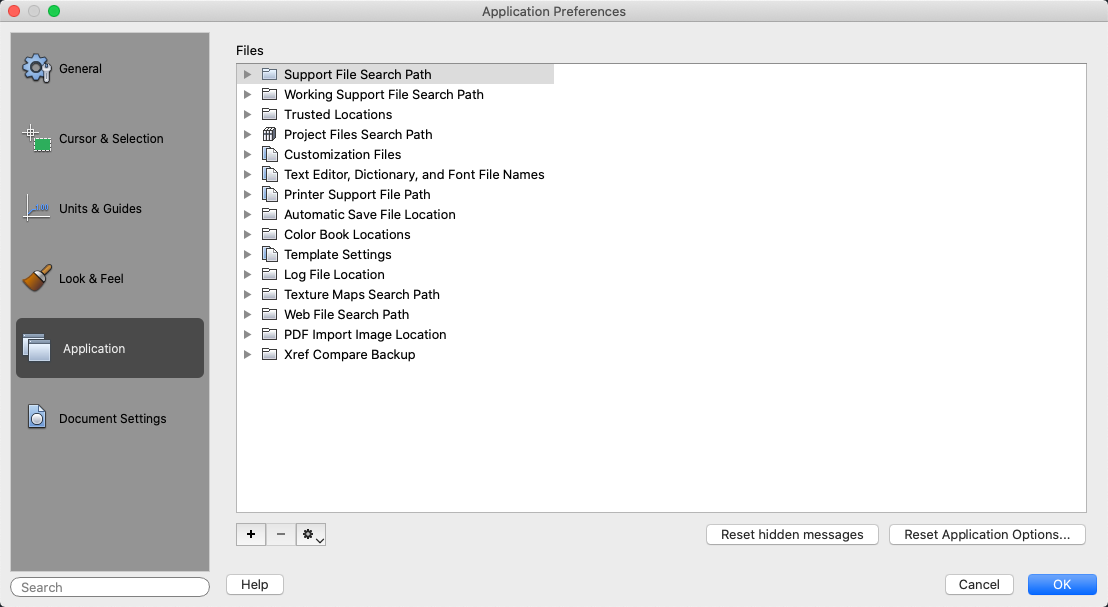

Application Tab (Application Preferences Dialog Box)
Lists the folders in which the program searches for support, driver, menu, and other files. Also lists optional, user-defined settings such as which dictionary to use for checking spelling.
OPTIONS (Command)
Menu: AutoCAD 2022 > Preferences
List of Options
The following options are displayed.
Support File Search Path
Specifies the folders in which the program should look for text fonts, customization files, plug-ins, drawings to insert, linetypes, and hatch patterns that are not in the current folder.
Working Support File Search Path
Displays the active directories that the program searches for support files specific to your system. The list is read-only and displays valid paths from the Support Files Search Path that exist within the current directory structure and network mappings.
Project Files Search Path
Specifies a project name for the drawing. The project name corresponds to a search path for external reference (xref) files associated with the project. You can create any number of project names with associated folders, but each drawing can have only one project name.
Trusted Locations
Specifies the folders from where AutoCAD can load and execute files that contain code. (TRUSTEDPATHS system variable)
Customization Files
Specifies the names and locations of various types of files.
Main Customization File
Specifies the default location of the main customization file (acad.cuix).
Custom Icon Location
Specifies the location for custom icons referenced by your customization files.
Command Aliases
Specifies the location of the PGP file that should be loaded when the program is started.
Text Editor, Dictionary, and Font File Names
Specifies a number of optional settings.
Alternate Font File
Specifies the alternate font to be used when the specified font file cannot be located. (FONTALT system variable)
If you click Browse, the Alternate Font dialog box is displayed, from which you can choose an available font.
Font Mapping File
Specifies the font mapping file to be used. (FONTMAP system variable)
Printer Support File Path
Specifies search path settings for printer support files.
Print Spooler File Location
Specifies the path for print spool files.
Printer Configuration Search Path
Specifies the path for printer configuration files.
Printer Description File Search Path
Specifies the path for files with a .pmp file extension, or printer description files.
Plot Style Table Search Path
Specifies the path for files with an .stb or .ctb extension, or plot style table files (both named plot style tables and color-dependent plot style tables).
Automatic Save File Location
Specifies the path for the file created when you select Automatically Save on the General tab. (SAVEFILEPATH system variable)
Color Book Locations
Specifies the path for color book files that can be used when specifying colors in the Color Palette dialog box. You can define multiple folders for each path specified. This option is saved with the user profile.
Template Settings
Specifies the drawing template settings.
Drawing Template File Location
Specifies the path to locate drawing template files used by the Select Template dialog box.
Project Template File Location
Specifies the path to locate project template files used by the New Project dialog box.
Default Template File Name for QNEW
Specifies the drawing template file used by the QNEW command.
Default Template for Layout Creation and Page Setups Overrides
Specifies the default template file that is used for creating new layouts and to store page setup overrides that can be applied to Publish operations from the Project Manager.
Log File Location
Specifies the path for the log file created when you select Maintain a Log File on the Open and Save tab. (LOGFILEPATH system variable)
Texture Maps Search Path
Specifies the folders to search for rendering texture maps.
Web File Search Path
Specifies the folders to search for photometric web files.
PDF Import Image Location
Specifies the folder where referenced image files are extracted and saved when importing PDF files.
Add
Adds a search path for the selected folder.
Remove
Removes the selected search path or file.
Options
Edits or changes the order of a selected path.
Change Path
Displays the Browse for Folder or Select a File dialog box, depending on what you selected in the Files list.
Move Item Up
Moves the selected search path above the preceding search path.
Move Item Down
Moves the selected search path below the following search path.
Set as Current
Makes the selected project or spelling dictionary current.
Reset Hidden Messages
Resets the display of all message boxes that you marked to not display again or to always use a specified option in them.
Reset Application Options
Displays the Reset Application Options dialog box. Click Restart AutoCAD to restore the program defaults.
Before the program is reset, many of the files that you can customize are backed up to an archive file with the naming convention of Settings Backup <Date> <Time>.tgz. The archive file is saved to /Users/<user name>/Library/Application Support/Autodesk.
The archive contains many of the customization files located in the following folders:
  • /Users/<user name>/Library/Application Support/Autodesk/local/AutoCAD {version}
  • /Users/<user name>/Library/Application Support/Autodesk/roaming/AutoCAD {version}
