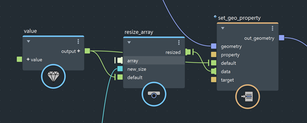

Show Names on Selected/Show Names on All
Displays the names above the selected nodes. If no nodes are selected, this affects all nodes instead.

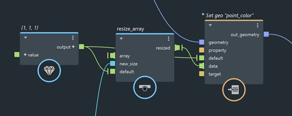

Show Values on Selected/Show Values on All
Displays the values above the selected nodes, if applicable. If no nodes are selected, this affects all nodes instead.
Values appear in italics to distinguish them from names.
