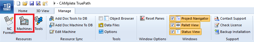

To override the H and D values, follow the steps below:
  1. Start TruePath.
  2. In the ribbon, go to Manage > Resources > Machines.
  3. Select the machine in the list, hold down the Shift key and click Edit.

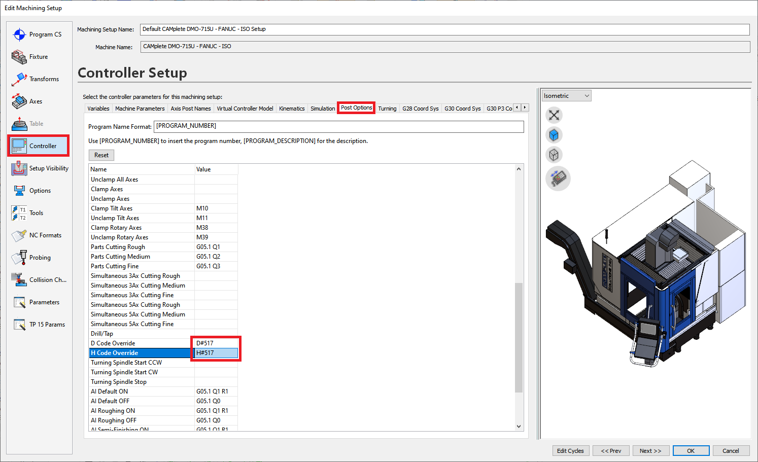

  4. Click Controller.
  5. Select the Post Options tab.
  6. Double click in the Value column and enter the value for D and H code override as below.
  7. Click OK to save the changes.
  8. Click Close to close the Resource Manager.
Next time a fresh project is created with the edited machine, the posted H and D codes should output the overrides.
