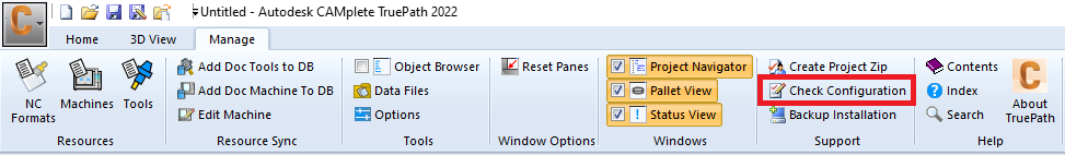

  2. When the machine installer is complete, open Autodesk CAMplete TruePath.
  3. In the ribbon, go to Manage > Support > Check Configuration.
    images
