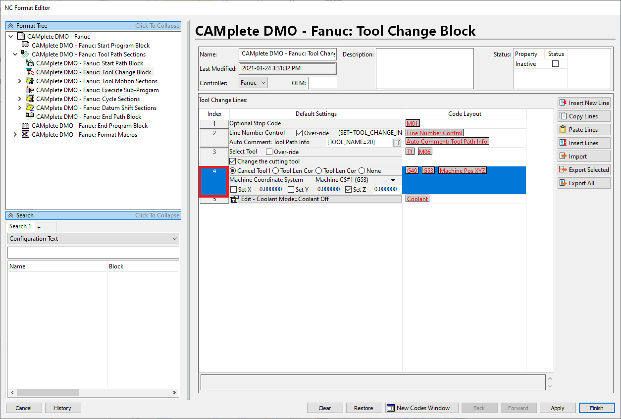

  5. Click in the Index column of the line immediately after the T1 M6.

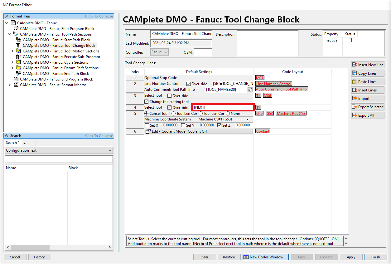

  6. Click Insert New Line.
  7. Click New Codes Window.
  8. Drag the T<tool id> command into the Code Layout column of the new line added in step 6.

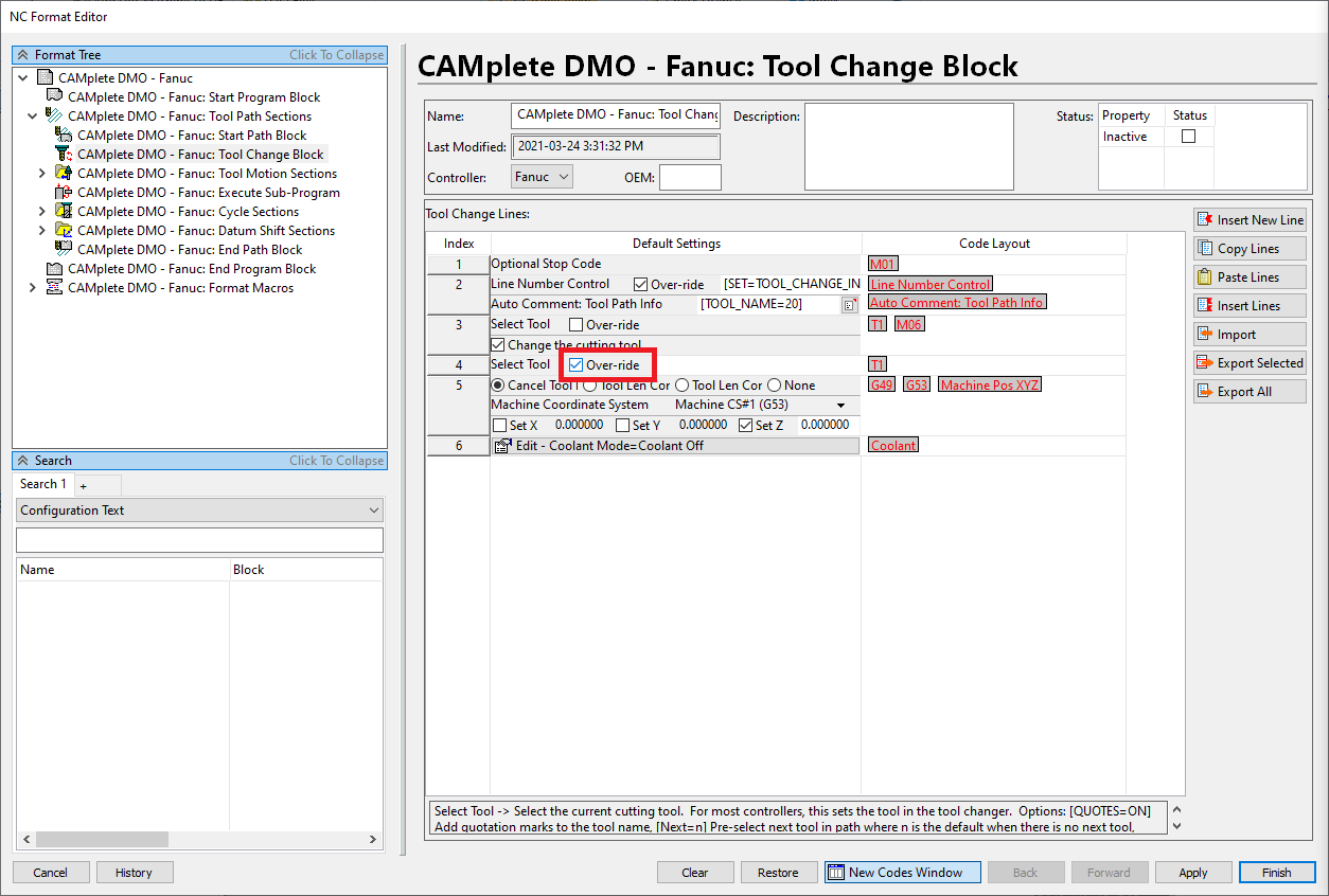

  9. Click the Over-ride checkbox.
  10. Set the over-ride text to [NEXT].
  11. Click Finish.
