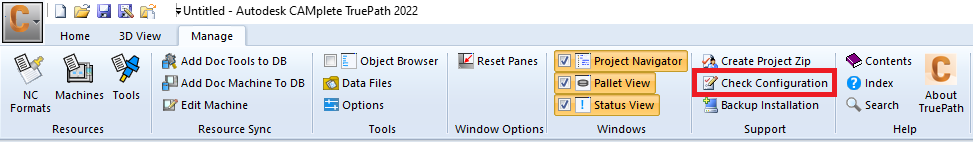

  3. In the ribbon, go to Manage > Support > Check Configuration.

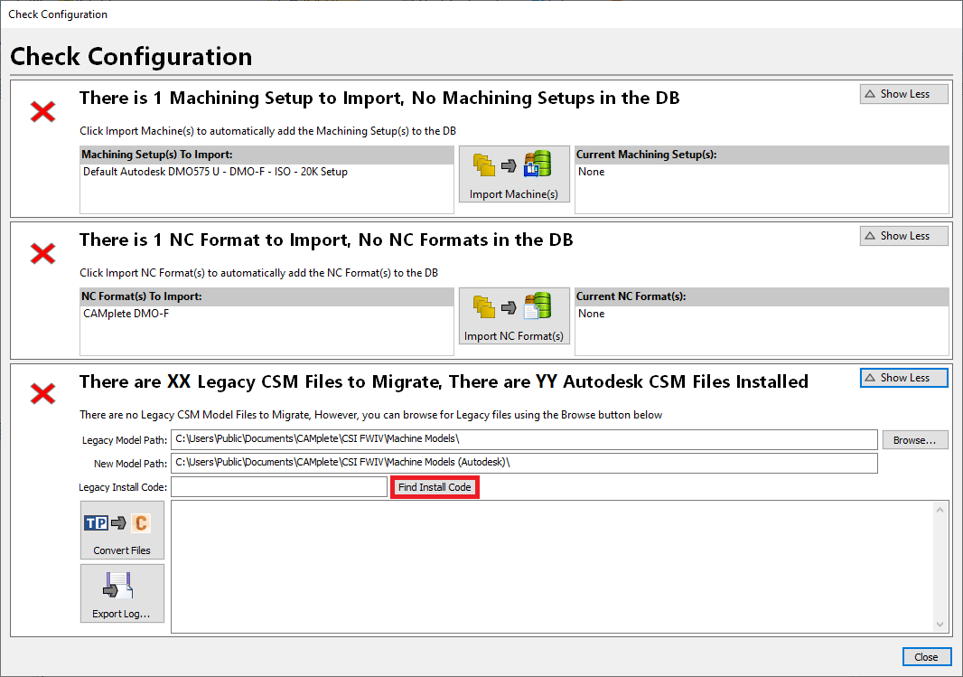

  4. Click Find Install Code. This will read the install code from your USB dongle.

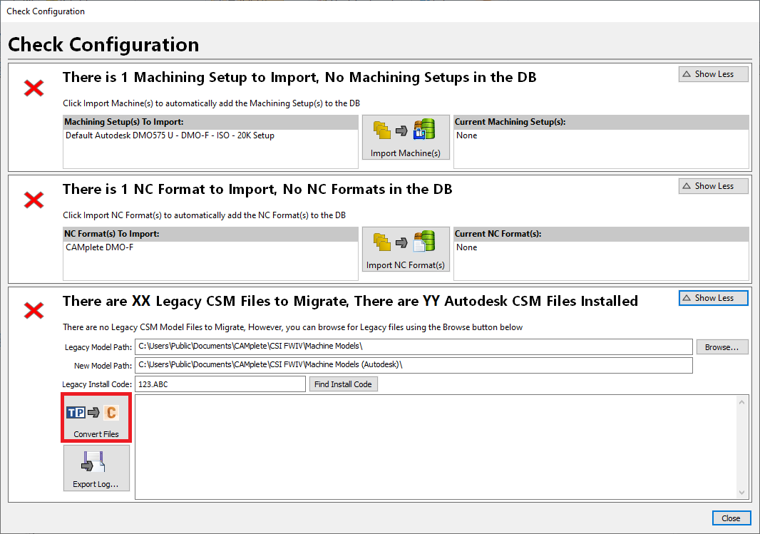

  5. Click Convert Files.
    images
  6. Once the machines have been converted, they will show up in the list of imported machines.

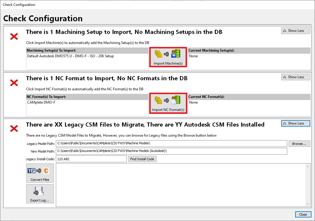

  7. To import any un-imported machines or NC Formats, click Import Machines and Import NC Formats.
