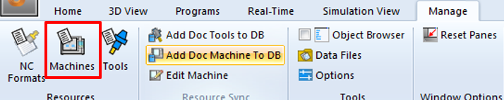

  1. To access the Machining Setup Manager, click Machines on the Manage tab:
  2. This accesses the Machines page of the Resource Manager.  Alternatively, you can access the Resource Manager using the Resources button at the bottom of the Project Navigator view:

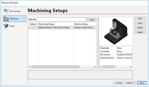

  3. The Resource Manager > Machines page lets you view and manage your machining setups (ie. Your machine models).
To copy and customize a default machining setup
  1. In the machining setup list, select the machine you want to copy.
  2. Click Copy and a new machine will appear with the same name but with “ – Copy #1” added to the name.
  3. Select the new copy in the list.

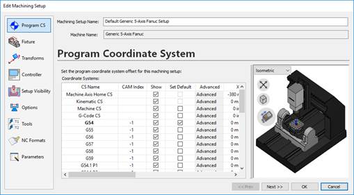

  4. Click Edit to launch the Machining Setup Editor:

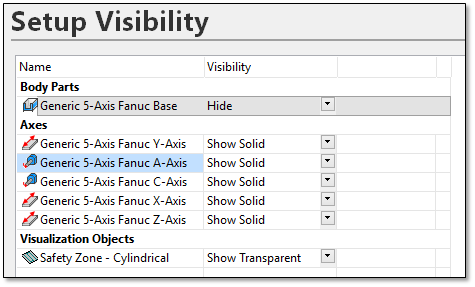

Adjusting the Setup Visibility
You can hide and show the different parts of the machine through the Setup Visibility page.  Thus you can control how the machine looks by default.
  1. Go to the Visibility Page.
  2. Modify the Visibility setting for each part of the machine.
  3. For this example, you can hide the base and enclosure geometry (if applicable):

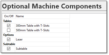

Adjusting the Machine Options
Some machines have optional components that can be enabled.  These can be things like laser measurement devices or alternative work tables.
  1. Click Options to access the machine options page.
  2. To disable or enable any options click the On/Off column:
    Note: As you change the options, the update will be shown in the 3D preview.  There may be a delay as the new geometry is reloaded.

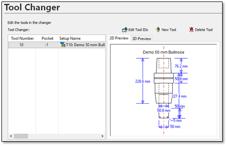

To customize the default tools in the tool changer:
Your machining setups can be preloaded with tooling setups that accurately match the physical tooling you use. Preloading tools in your machining setup allows Autodesk CAMplete TruePath to automatically replace tools loaded from your CAM files when an appropriate tool is available.
  1. Click Tools to access the Tool Changer properties for the machine.
  2. Click New Tool.
  3. Select the tool assembly “Demo 50 mm Bullnose (5 mm rad)” you created earlier.
  4. Double-click the tool number for the assembly in the grid.
  5. Type 10 in the Tool Number field and press Enter.
  6. You can also specify a Default Holder that will automatically selected whenever tools are loaded that contain no tool holder info.  This can be selected by clicking Change and selecting the new default holder from your database of holders.

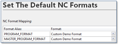

To assign a default NC Format to the machining setup
You can configure your machining setups to use a default NC format. Autodesk CAMplete TruePath automatically selects the default NC format for you every time you use this machining setup.
  1. Click NC Formats to access the Default NC Format Properties page.
  2. Select the NC format you created earlier as the Default NC Format for Programs.
  3. For this example, select the “Custom Demo Format” as the default:
