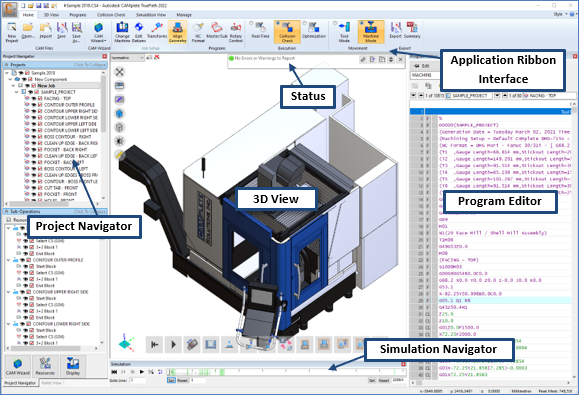

Now that you have completed the initial setup of your project, Autodesk CAMplete TruePath loads your project data into the main user interface consisting of a series of dynamically docking “views” built around the 3D view:
3D View – displays a visual representation of your tool paths. By default, green indicates cutting (linear or arc) motion, and blue indicates rapid motion.  Canned Cycles combine both types of motion.
Project Navigator – displays a tree-based, hierarchical description of your project. When you select items in the tree, you control what is displayed in the other views.
Program Editor – displays the posted G-Code, the original CL data, any warnings and extra calculated data.
Simulation Navigator – controls the simulation playback.
Status – provides feedback during simulation and shows the application log.  Any errors will be flagged in this view.

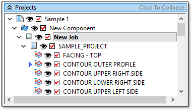

The Project Navigator
The Project Navigator view shows the construction of the various programs in your project.
  1. The Project Navigator is broken into 3 sections:
  2. The Projects section shows the Project > Component > Job objects which allow you to organize your project.
  3. Under the Job appear all of the programs and operations.
  4. As you select items in this upper tree, you are choosing what is part of the simulation and what appears in the Program Editor view.
    For example, if you select the Job object, then all programs will be simulated (in order) and they will all appear in the Program Editor.  If you select just a single program, then only that program will be simulated and appear in the Program Editor. Further, you can select just a single operation which helps you zero in on a more manageable portion of your program.
    As you select each object in the Projects tree, the items shown in the lower Sub-Operations tabs will also change.
  5. Clicking the Projects “bar” will collapse or expand the Projects tree.

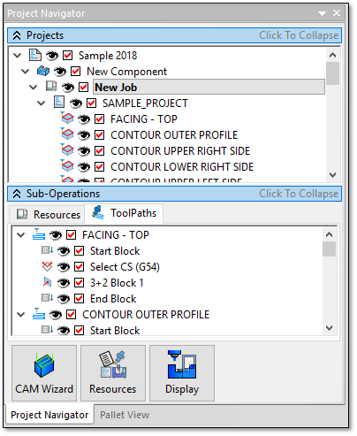

  6. The Sub-Operations tabs show more details information about the items selected in the upper tree.  The available tabs are:
    Geometry – Shows any part geometry associated with the selected object.  This tab appears when you select the Component object in the upper tree.
    Resources – Shows any resources associated with the selected object.  Resources include cutting tools and the milling machine.  The machine resources will appear only when you select the Job object in the upper tree.
    ToolPaths – Shows the detailed tool path(s) associated with the selected object.  If you select a job or program, all tool paths belonging to that item will be shown.  If you select an operation, only that tool path will be shown.  The tool path contains the actual CAM data describing how the tool moves.
    History – Shows the history of the operation.  This is only displayed when an operation is selected in the upper tree.  Usually, you will only see the Import operation appear in this tab since manually editing operations is not usually required.
  7. Clicking the Sub-Operations “bar” will collapse or expand the Sub-Operations tree.
  8. The Project Navigator View also contains quick access buttons at the bottom for the CAM Wizard, the Resources and the Display Wizard.  These are explained in other sections of this manual.

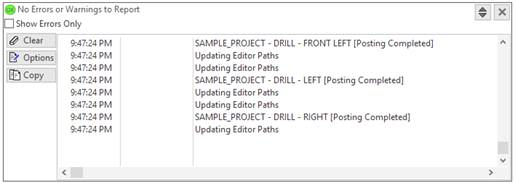

The Status window
The Status window is an overlay in the upper right corner of the 3D view.
  1. The Status window originally appears in its collapsed state in order to take up as little screen as possible:
  1. While collapsed, a summary will be shown.  If errors are reported, the number of errors are warnings will be displayed.
  2. The Status window buttons are:
    Clear – Clear the current list of status entries.
    Options – Adjust the Status window options.
    Copy – Copy the currently selected status entries to the Windows clipboard for pasting into other applications as text.
    Collapse/Expand – Toggle between the expanded and collapsed state.
    Close – Close the status view.  The status view will re-appear if any errors or warnings are reported.
  3. Click the Expand button to show the full status view.
  4. Un-check the Show Errors Only button to show all reported status items:
  5. Click the Collapse button to make the status view small again.
