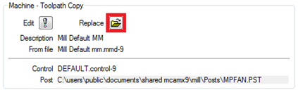

  6. Click Replace.
    images
  7. Select the machine definition for your machine.
  8. Click Open.
  9. Click the green check mark.

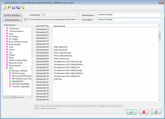

  12. Go to Text > Canned Text.
  13. Scroll down until you see a series of empty canned text entries.
  14. Double-click in the canned text columns of each empty row and enter the text for the HSM modes. Here is a screenshot of HSM modes starting at canned text entry 20.
    images
  15. Record the canned text numbers used in the previous step. You will later map them in TruePath.
  16. Click the Save icon to save the control definition.

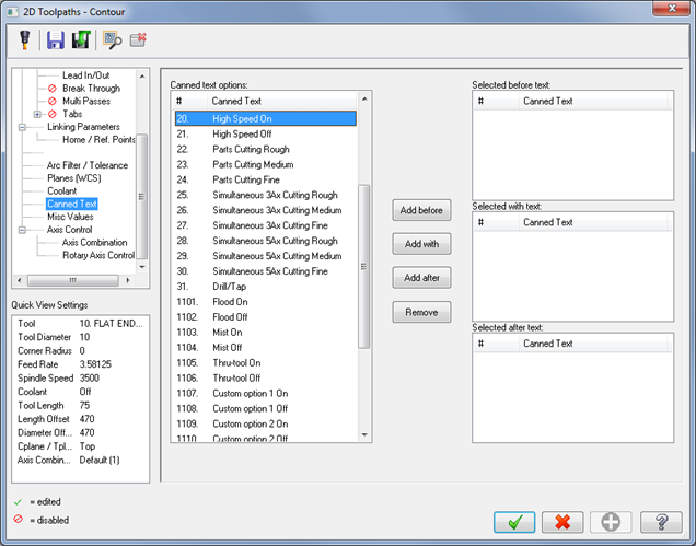

    The canned text options in the Mastercam toolpaths now include the HSM modes when you use the edited machine definition. You can apply them like any other canned options.
    images

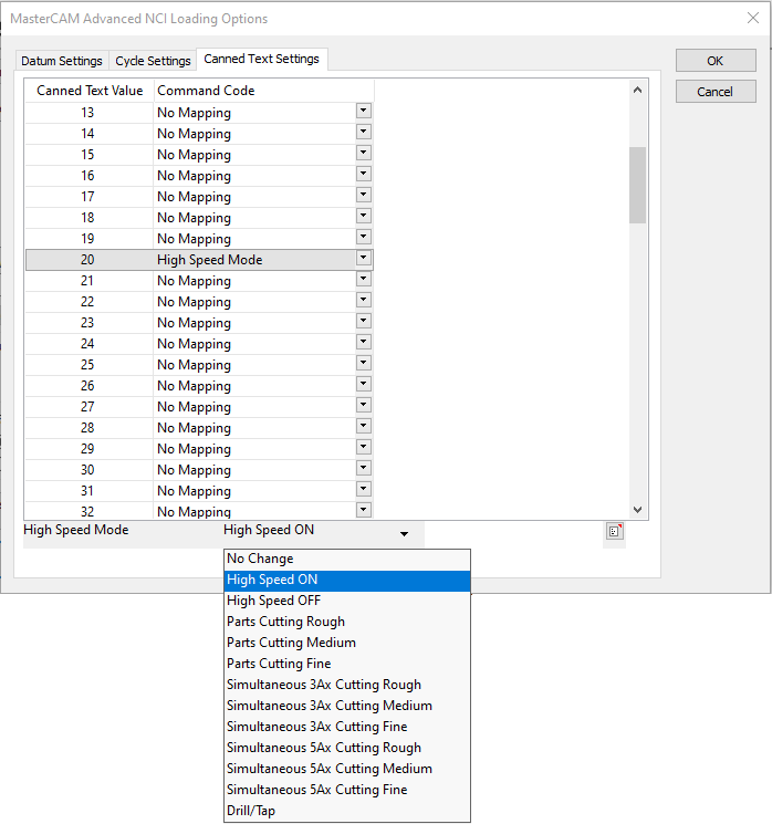

  6. Click the Canned Text Settings tab.
  7. Scroll down to the canned text values. In this example, the canned text values are in rows 20 through 31.
  8. For each canned text value, use the drop-down menu in the Command Code column to map the High Speed Mode command.
  9. Use the drop-down menu at the bottom of the window to set the specific HSM mode for each canned text value.
    images
  10. Repeat steps 8 and 9 for each canned text value.
  11. Click OK.
