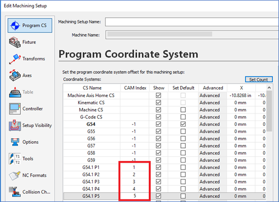

    For Fanuc machines:
    This example maps CAM indexes 1 through 5 to coordinate system G54.1 P1 through G54.1 P5, respectively.
