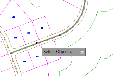

  1. Open a drawing that has an existing alignment you want to create a pressure network along.
  2. Click Home tab glyph Create Design panel glyph Pipe Network glyph Create Pressure Network from Object.
  3. Select the alignment in the drawing:

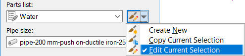

    • Parts list: Click the Edit Current Selection option and check the parts list to ensure it has the diameter of pipe and corresponding elbows you need.
      Review the parts list, add parts that you need, and click OK.

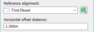

    • Select a reference alignment from the Reference Alignment list that will be used for station and offset values.
      Then specify a Horizontal Offset Distance to offset the new pipe run relative to the selected object (enter a negative value to offset a distance to the left of the object, or a positive value to offset to the right):

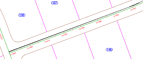

      The pressure network is created at an offset from the alignment.

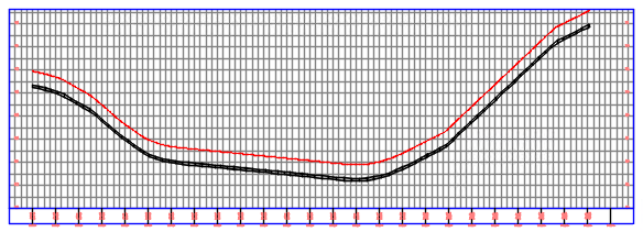

  6. On the Pressure Network contextual ribbon, on the Profile panel, click Pipe Run Profile to display the Pipe Run Profile Settings dialog box.
  7. Under Offset Style, select Cut Length.
  8. Under Draw Profile In, select New Profile View.
  9. Click OK to display the Create Profile View wizard.
  10. Click the Next button until you reach the Pipe/Pressure Network page.
  11. Review the pipe and fitting list to ensure all the desired pipes and fittings are included.
  12. Click Create Profile View.
  13. Select a location in the drawing and click to place the profile.

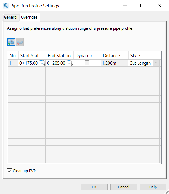

  15. On the contextual ribbon tab, click Pipe Run Profile.
  16. In the Pipe Run Profile Settings dialog box, click the Overrides tab.
  17. Click the Add Offset Preferences for a Station Range button to add an override.
  18. Define the start and end station for the override range by picking stations in the drawing.
  19. Clear the Dynamic check box.
  20. Select the Clean Up PVIs check box.
  21. Click OK to create the range in the drawing.
  22. Select the pipe run in the profile view and click Add Bend/PVI from the Layout panel.
  23. Click to add bends to the pipe run so that the pipe run is moved around the obstacle.
  24. Press ESC to deselect the pipe run.
    Now the majority of the pipe run is following the surface profile, except for the region in which the override was created.
