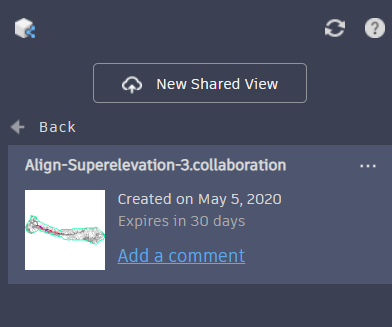

In the Shared Views panel, click New Shared View.
Enter a name for your shared view.
Select which view you want to share. You have the option to share the current view or share the model view and all layout views.
Select Share to create a visual representation of the drawing in the Autodesk Viewer. Civil 3D will begin processing your shared view. Your shared view will appear in the Shared Views panel after the processing is complete.
After the processing is complete, click
next to the shared view. From the drop-down menu, you can copy a link to the shared view, open the shared view in your default browser, extend the shared view, or delete the shared view.
