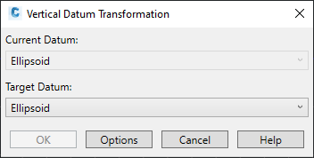

Use the Vertical Datum Transformation tool to shift elevations from one vertical datum to another.
Drawing Transformations and double-click Vertical Datum Transformation.
The Vertical Datum Transformation dialog box opens.
See Vertical Datum Transformation Dialog Box for more information.
The datum options are determined by an International Service for the Geoid (ISG) file of Earth Gravitational Models (EGM) installed to C:\ProgramData\Autodesk\C3D <year>\enu\Geoid Models.
There are many different additional models listed at ISG - International Service for the Geoid. The list includes a list of public, private, and on demand models encompassing over 100 countries (and with multiple versions of each).
Click OK to make the transformation.
When complete, the drawing is marked with the target datum. The drawing cannot be double transformed but can be transformed again to another vertical datum or back to its original datum.
