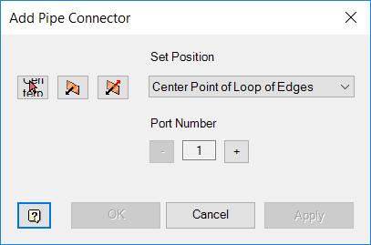

  1. Once you have completed your sketch and extrusion in Autodesk Inventor, Click Environments tab Infrastructure Part Shape Utilities Pipe Connector.
    The Add Pipe Connector dialog will display.
  2. Click the Set Position icon .
  3. Click to place the pipe connector on a face and/or work plane in your shape model.
    Be careful to also specify the proper direction for the pipe connector(s) you add. You can click Change Direction or Flip Direction to modify the design direction for your pipe connectors.
  4. Click OK.
