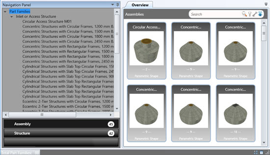

Drainage Structures
Drainage Structures are organized by Assembly and Structure in the Navigation Panel of the Parts Editor.
Each type of part assembly is composed of multiple parts families and multiple part size variations.
Inlet and Access Structures: An assembly class made up of inlets and manholes. An inlet and access structure assembles an inlet frame with an underlying catch basin structure and a cover or grate. Surface Structure parts are the Inlet or Inlet Frame base parts for Inlet and Access Structure assemblies. The sizes defined for the Surface Structure part families are the sizes that you see in the assembly. Each part size is matched to the appropriately sized Underground Structure (also known as a catch basin) and a Cover or Grate(also known as a manhole).

For Piping catalogs in the Parts Editor, there are many types of piping assemblies that can be created using piping parts families. For example, you can create a Fittings assembly from Adapter, Cap, Coupling, Cross, Elbow, Plug, Reducer, Lateral, Tee, and Wye part families, or you could create a Valves and Operators assembly using Hydrant, Valve, Valve Actuator, and Valve Body part families, as shown in the image below.
