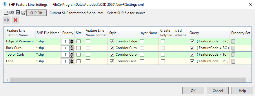

To create a feature line setting in a new feature line settings file
- In the Toolspace, on the Toolbox tab, expand SHP Import/Export Utilities
SHP Import/Export
Settings. Double-click Edit Feature Line Settings to open the
SHP Feature Line Settings dialog box.
- Click
to create a new feature line settings file.
- Click
to add a new setting.
- Name the new feature line setting.
- Define the values for the new setting's parameters, as needed:
- Feature Line Setting Name
- SHP File Name

SHP file selection and attributes
- Click SHP File in the SHP Feature Line Settings dialog box to display the Open Shapefile Information File dialog box, and then select a shapefile to which the feature line settings in the current settings file will apply.
- Use the shapefile to specify attributes for the individual feature lines settings in the current feature line settings file.
- Click OK to save the new file and its settings.
If you are in the process of importing SHP survey data, you may be ready to return to either the Import SHP Data Settings dialog box or the Import SHP Survey Data dialog box to complete the import process, or you can create or edit point settings.
