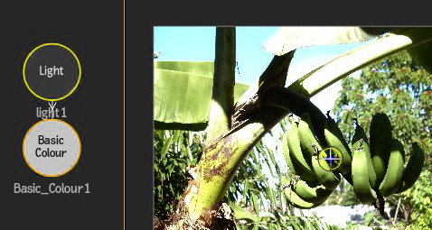

The Lightbox node is added to the scene as a child of the selected Light. If no light was selected prior to adding the Lightbox node, a new Directional Light is added to the scene as the parent of the Lightbox node.
Tip: Lightbox nodes are displayed as white in the schematic to help you identify them. If you added the Lightbox from the dynamic node bin, the name of the effect also appears on the node in the schematic.
- Double-click the Lightbox node in the schematic to display its menu.
The Lightbox node populates the menu dynamically, based on the .glsl (and .xml) code, but there are a few UI elements that are constant, located in the Shader tab.
