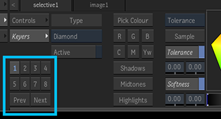

Navigating with the Selectives Manager
The Selective Manager allows you to create, select, copy, and delete Selective nodes and their effects. The Selective Manager is displayed in the Controls menu of a Selective node.
Whenever you add a selective to a surface or a camera, it is assigned an ID, a number between 1 and 48. That ID is displayed in the Selective node's Unique ID field, in the Controls tab. This is the ID used in the Selectives Manager, as well as in the HUD.
Important: Each surface and camera has its own Selective pipeline: the a Selective's ID is only unique within a surface's pipeline, but the same ID can be assigned to Selectives parented to different surfaces.
You navigate to a Selective by clicking its number in the Selective Manager. A blue number in the Manager indicates a Selective is assigned that ID.
