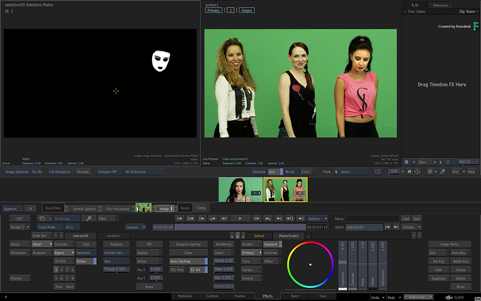

If your image contains more than one person and you're using a Human (body, head, face) keyer, you target a specific person, the Human keyers allow you to also extract a single object from the image.
To target a specific talent:
- In the Selective node, open the Semantic Keyer menu.
- Select a Human keyer (body, head, face) and click
Active.
- Set
Target Selection to
Selected.
- In a viewport, display the Selective Input (F9) view.
A yellow crosshair appears in the middle of the viewport.
- Move the crosshair onto target the talent to isolate.
Notice how the crosshair snaps to the talent; t he larger the crosshair, the better the recognition.
- If the target moves from frame to frame, enable Auto Key and animate the crosshair to follow the target. Use the
Min
and
Max
fields to expand or restrict the coverage.

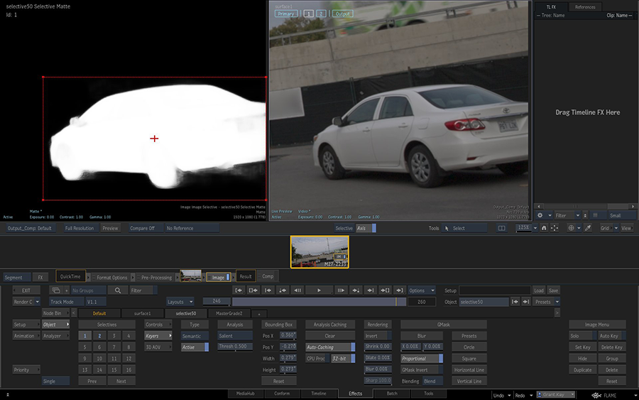

Semantic Keyer - Salient
Use the Salient keyer to isolate the most obvious object within a bounding box.
The Salient keyer is not object specific (as opposed to other semantic keyers such as Sky or Human Head), and tries to isolate any object within the box.
To key an object using the Salient Object keyer:
- Select a Selective from the Selectives HUD.
- In the Selective menu, open the Keyers menu.
- Set Type to Semantic.
- Set Analysis Mode to Salient.
- Click Active.
To see Salient in action:
- Display a 2-Up view using
ALT+2.
- Select a viewport and press
F9 until you get to the Selective Matte view.
The viewport now displays the matte of the isolation performed by the Salient keyer.
- In the other viewport, press
F9 until you get to the Selective Input view.
The viewport highlights with an overlay the items being detected by the Salient keyer within the red bounding box.
- Use Threshold to control the quality of the isolation.
The Salient keyer does not recognize object but shapes, you must tell it where to look: it then looks within that area to detect a shape. And you tell it where to look using the bounding box as it is the area of the image analyzed by the Salient keyer.
To isolate a specific object:
- In a viewport, use
F9 to display the Selective Matte or Selective Input view.
- Use the cursor to move and resize the bounding box to focus the Salient keyer on a specific object.
You can also use the controls in the Salient object menu to move the bounding box.
Note: You can set keys and animate the bounding box over time.
