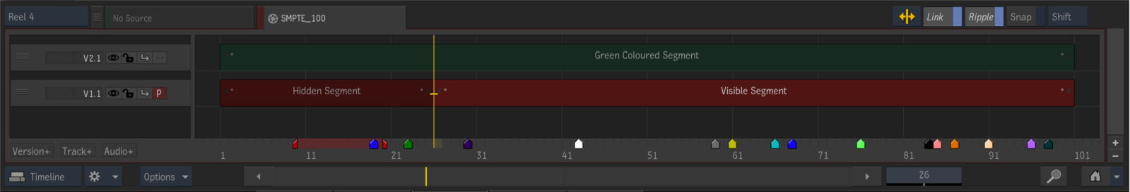

Hiding Timeline Segments
It is also possible to hide a Timeline segment using the Hide Segment function from the contextual menu of the Timeline segment in question. Hidden segments are slightly darker than visible segments, as seen in the screenshot below.
To restore a segment’s visibility status, select Show Segment, from it’s contextual menu.
