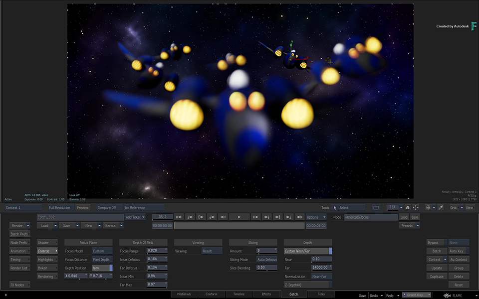

The PhysicalDefocus matchbox completes the previously released Physical Bokeh and Convolve by adding depth support to the same convolution engine.
This node offers two independent Defocus model: a custom one and a physical. The node also offers different ways to set the focus plane, as well as leverages the Action Camera value. Finally, you can use its procedural kernel for the bokeh, provide your custom kernel, or use the PhysicalLensKernel matchbox.

The Focus model sets the behaviour of PhysicalDefocus. Three behaviours are available: Custom, Physical, and Action Camera. Each option comes with its own set of Depth of Field controls.
