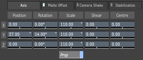

Axis Settings
- Position X field
- Displays the X-axis offset applied to the clip. Editable.
- Position Y field
- Displays the Y-axis offset applied to the clip. Editable.
- Position Z field
- Displays the depth offset of the clip. Available when Transform Type is set to Perspective. Editable.
- Rotation X field
- Displays the degree of rotation on the X axis. Available when Transform Type is set to Perspective. Editable.
- Rotation Y field
- Displays the degree of rotation on the Y axis. Available when Transform Type is set to Perspective. Editable.
- Rotation Z field
- Displays the degree of rotation along the Z axis. Available when Transform Type is set to Perspective. Editable.
- Scale X field
- Displays the X-axis scaling offsets applied to the clip. Editable.
- Scale Y field
- Displays the Y-axis scaling offsets applied to the clip. Editable.
- Scale Z field
- Displays the Z-axis scaling offset. Available when Transform Type is set to Perspective. Editable.
- Proportional button
- Enable to affect the Scale fields proportionally.
- Shear X field
- Displays the offset value for the horizontal edges of the clip. Available when Transform Type is set to Perspective. Editable.
- Shear Y field
- Displays the offset value for the vertical edges of the clip. Available when Transform Type is set to Perspective. Editable.
- Shear Z field
- Displays the depth value of the horizontal edges of the clip. Available when Transform Type is set to Perspective. Editable.
- Centre X field
- Displays the centre point value of the clip along the horizontal axis. Available when Transform Type is set to Perspective. Editable.
- Centre Y field
- Displays the centre point value of the clip along the vertical axis. Available when Transform Type is set to Perspective. Editable.
- Centre Z field
- Displays the centre point value of the clip along the Z axis. Available when Transform Type is set to Perspective. Editable.

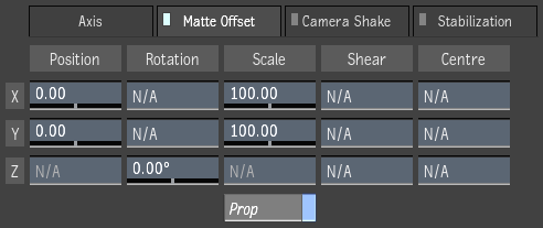

Matte Offset Settings
- Position X field
- Displays the X-axis offset applied to the matte. Editable.
- Position Y field
- Displays the Y-axis offset applied to the matte. Editable.
Rotation Z field
- Displays the degree of rotation along the Z axis. Editable.
- Scale X field
- Displays the X-axis scaling offset applied to the matte. Editable.
- Scale Y field
- Displays the Y-axis scaling offset applied to the matte. Editable.

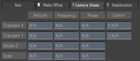

Camera Shake Settings
- Camera Shake button
- Enable to simulate camera shake in the image.
- Translate X Amount field
- Displays the amount of horizontal movement applied to the clip. Editable.
- Translate Y Amount field
- Displays the amount of vertical movement applied to the clip. Editable.
- Rotation Z Amount field
- Displays the degree of rotation on the Z axis.
Available when Transform Type is set to Perspective.Editable.
- Scale Amount field
- Displays the amount of scaling applied to the clip. Editable.
- Translate X Frequency field
- Displays the frequency of horizontal movement applied to the clip. Editable.
- Translate Y Frequency field
- Displays the frequency of vertical movement applied to the clip. Editable.
- Scale Frequency field
- Displays the frequency of scaling applied to the clip. Editable.
- Rotation Z Frequency field
- Displays the frequency of rotation on the Z axis.
- Translate X Phase field
- Displays the phase of horizontal movement applied to the clip. Editable.
- Translate Y Phase field
- Displays the phase of vertical movement applied to the clip. Editable.
- Rotation Z Phase field
- Displays the phase of rotation on the Z axis. Editable.
- Scale Phase field
- Displays the phase of scaling applied to the clip. Editable.
- X Centre field
- Y Centre field

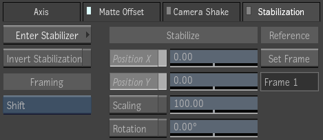

Stabilization Settings
- Enter Stabilizer button
- Enable to enter the Stabilizer editor.
- Invert Stabilization button
- Enable to apply an inverse of the stabilization data to recreate the original camera shake.
- Framing Mode box
- Select a method to fill or remove the area where the image has been shifted after stabilization.
- Position X button
- Enable to include the X-axis position in the stabilization.
- Position X field
- Displays the amount of stabilization data found in the animation channel for the X position.
- Position Y button
- Enable to include the Y-axis position in the stabilization.
- Position Y field
- Displays the amount of stabilization data found in the animation channel for the Y position.
- Scaling button
- Enable to include scaling in the stabilization.
- Scaling field
- Displays the amount of stabilization data found in the animation channel for scaling.
- Rotation button
- Enable to include the rotation in the stabilization.
- Rotation field
- Displays the amount of stabilization data found in the animation channel for rotation.
- Set Frame button
- Enable to set the current frame as a reference frame that has no transformation data.
- Reference Frame field
- Displays the frame number of the reference frame that has no transformation data. Non-editable.
