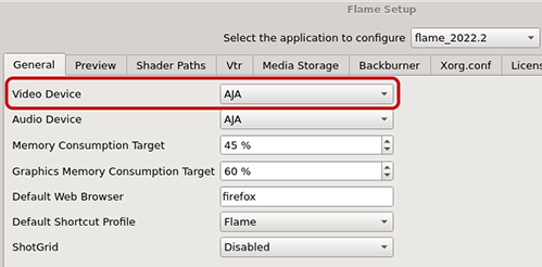

Removal of hard-coded AJA card models and new generic AJA token in init.cfg
In previous releases, AJA video cards were initialized based on the card name selected in Flame Setup. This meant you needed to know the exact hardware installed on your workstation to properly configure Flame Family products.
Flame Family 2022.2 Update introduces a new generic AJA card naming convention to detect the card. You no longer have to select a specific AJA card in Flame Setup to properly use it.
To enable AJA video card in Flame Family products:
  1. Open Flame Setup.
  2. In General, set Video Deviceto AJA.
  3. Save and close Flame Setup.
    You can start your Flame Family product and use the AJA hardware for video output and monitoring.
Note: Legacy init.cfg files are still supported.
