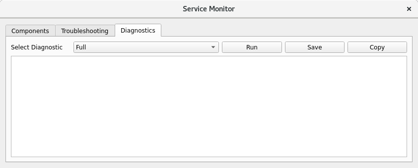

You can now use the Service Monitor to display warnings and error messages from the log files. You can also disable services.
In addition to making it easier to view warnings and errors, the new Diagnostics tab makes it easier to provide system information to Autodesk Support.
The available reports are:
Full: Displays all the log files in a consolidated report.
Errors / Warnings last day: Reports all the errors and warnings for the last 24 hours.
Error / Warning last Application Execution: Reports all the errors and warnings since the last diagnostic run.
Network Ports: List the network ports currently used by the different Flame Family services.
Services Status: Status of the different Flame Family services.
Services System Errors: Errors reported by the different Flame Family services.
Services System Errors (Since Boot): Errors reported by the different Flame Family services since the last workstation reboot.

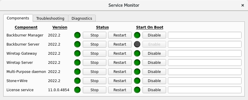

In the Components tab, you can now disable a service.
Disabling a service prevents it from starting even after a restart of the workstation. A service remains disabled until you re-enable it.
