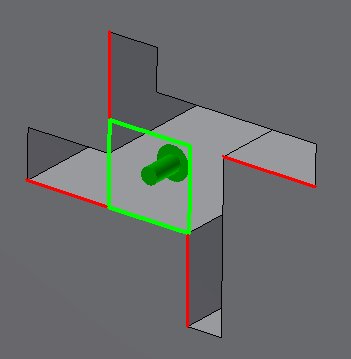

  • Four edges that define a rectangle as illustrated below.
