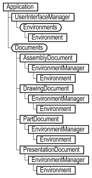

Environments Object Model Diagram

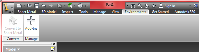

The samples that follow show how to add new environments to Autodesk Inventor. The figure below shows the initial view of the Applications menu and the panel bar, with no additional environments or edit targets added. The example code will add three new environments. Lastly, it will create an edit target within one of these environments.

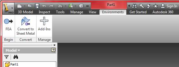

All that remains is to add the new environment to the list of parallel environments (thus adding the environment to the list of available environments, as indicated by the Applications menu shown in the figure below.

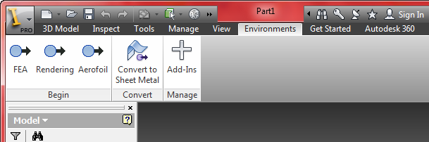

The preceding code will add the new FEA, Rendering and Aerofoil environments to Autodesk Inventor's Applications menu, as shown below. Each environment has its own set of command bars, but so far none has a specific edit target defined.

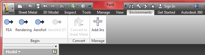

The result of this code is indicated in the following figure. Note that the Applications menu now has the new Aerofoil-ET edit target checked instead of the Part edit target. Note too the change to the panel bar.
Although the previous edit target is not persisted in the sense that it will not be active when the document is next loaded, you can return to this edit target by calling the SetCurrentEnvironment method again.
