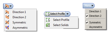

The MiniToolbarDropdown object represents a dropdown control within a MiniToolbar. The pictures below illustrate various types of drop downs.
