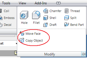

CommandControls Property that returns the CommandControls collection object that provides access to all the visible controls within the panel.
DisplayName Property that returns the display name of the ribbon panel.
Docked
InternalName Property that returns the unique internal name of the ribbon panel.
Parent Property that returns the parent RibbonTab object.
SlideoutControls Property that returns the CommandControls collection object that provides access to all controls in the slideout section of the panel.
