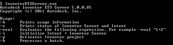

-h
Prints help information.

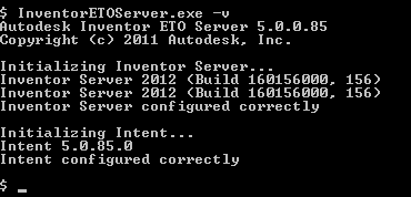

-v
Verifies that Inventor Server and Intent are initializing correctly:

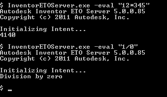

-eval
Evaluates the expression in the command line. The result or error is sent to standard output:

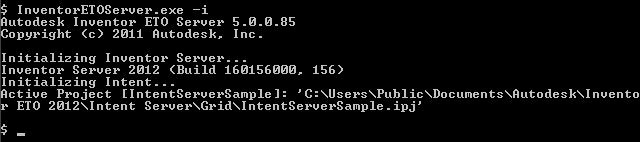

-i
Prints out short Name and the full path of the active Inventor project:

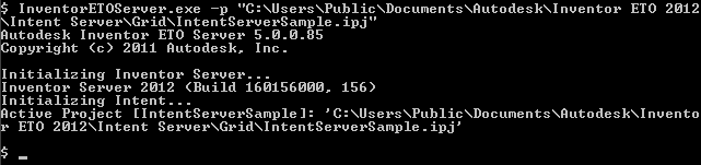

-p
Activates Inventor project. The short Name or the full path to the IPJ file are accepted:

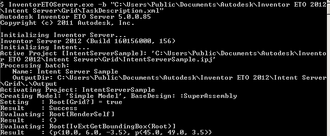

-b
Processes batch job. The next argument specifies the Task file name:
The console output varies depending on contents of the task file, see the Task File topic.
