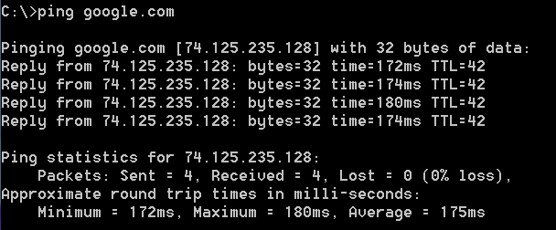

Ping
Ping is a command line tool available for most operating systems. To use ping, on any command line, enter ping <server url>.
Ping sends a packet of data to the specified server and waits for a response. It displays the time it takes for the packet round trip. Use ping to measure the latency time of the server connection.
Note: In Windows server, it is sometimes necessary to enable/allow ping requests. Consult your operating system documentation for instructions on how to enable ping requests.
