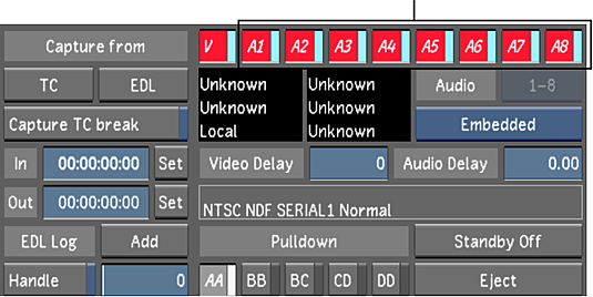

Select the audio file type, bit depth, and determine if you want to capture the audio tracks as a single or multiple files. Single File Capture is enabled by default.
Enable the audio track(s) you want to capture.
Click the TC button to start the capture.
