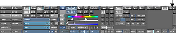

To copy channel parameters from the current shot to selected shots:
  1. Click Selector.
  2. Select your target shots by completing one of the following:
    • To select your shots one at a time in the Storyboard, right-click specific shots in the Storyboard.
    • To select your shots one at a time in the Timeline, left-click specific shots in the Timeline.
    • To select all the shots in the Storyboard or the Timeline, click SelectAll in the Selector.
    The target shots are highlighted in aqua.
  3. Click the shot from which you want to copy parameters.
  4. Specify what parameters to copy by selecting their channels in the Selector channel list:
    • To select all the channels in a directory, select the directory.
      (a) Collapsed directory  (b) Expanded directory  
      Selected channels are highlighted.
    • To select specific channels in a directory, expand the directory and select any of its channels.
      (a) Selected channel  
  5. Click Copy.
    The parameters for the selected channel are copied to the selected shots.
